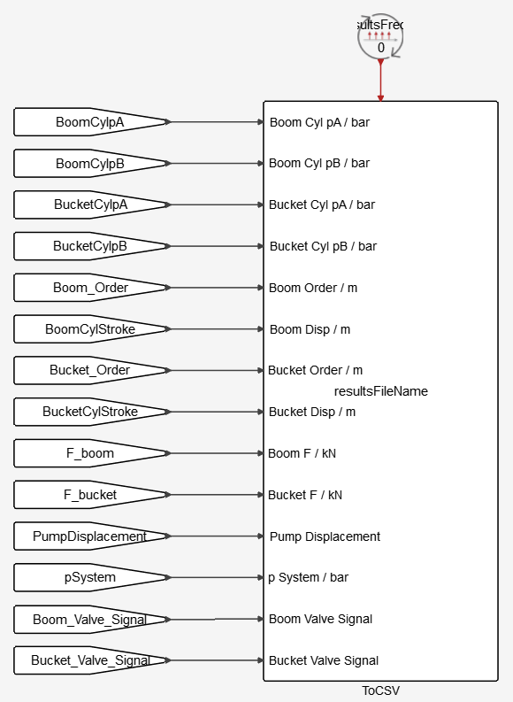

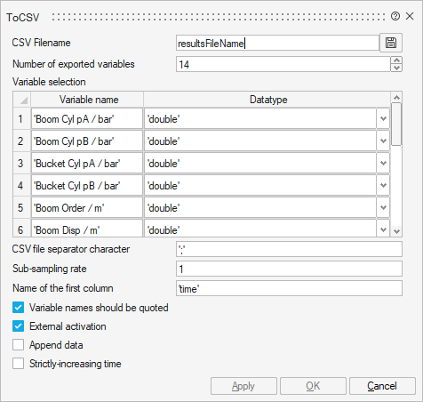

There are several ways to save simulation results to file. Today I'm using ToCSV block to write directly into a file during simulation
I can easly define the sampling time (event control), set the filename by variable and switch between overwrite and append data.

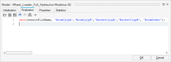

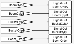

As an alternative I can write variables into workspace and save them after simulation into file (here mat-file)
To determine the sampling rate I also can use event control with SignalOut block.
