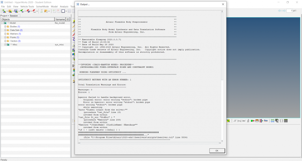

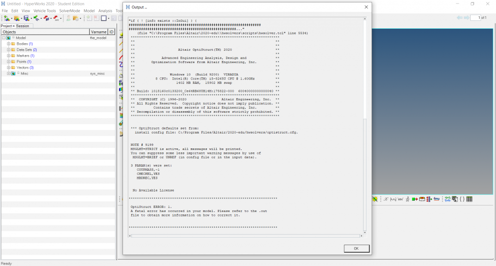

I am facing some issue while converting my Trailing arm  rigid body template to flexible motion view for fem analysis. When I complete the flex prep pop i encountered an error regarding the optistruct licence.

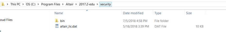

    do you have altair_lic.dat file ? if yes, are you sure that the *dat file is in the right directory ?

    After downloading the license file, rename it to altair_lic.dat and place the same in the <installation directory>/security folder
    If you have already done the above and still face the error, Use windows folder options / view > display file name extensions, to make sure the file is named altair_lic.dat and not altair_lic.dat.dat,

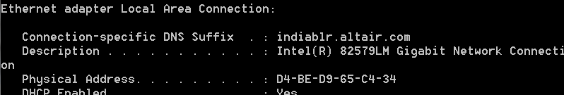

    Run ipconfig/all in command window and check for physical address under Ethernet adapter local area connection:
    The listed physical address under Ethernet adapter local area connection should be used to generate the license file, if there is no listing of Ethernet adapter local area connection, the address under Wireless Adapter LAN Wifi must be used.

    It's NOT Ethernet (or Wireless) IP address, but the Physical address MAC (https://en.wikipedia.org/wiki/MAC_address)
    So your Ethernet & Wireless cards have different address MAC, never the same!
