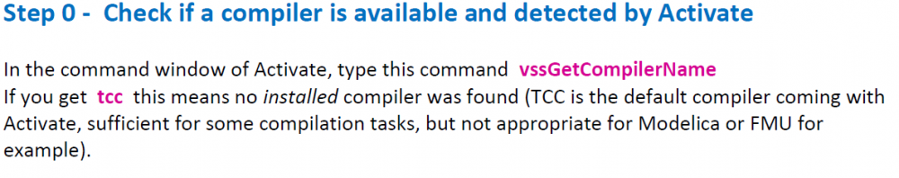

    When execute the 'vssGetCompilerName' i get the error message in the screenshot below, and not the 'tcc' line as it is stated in the 'Compiler Installation Guide'
    Greetings,
    Aiko
