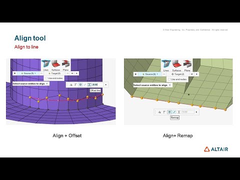

Hello,
Projected start and end point of input (red) line on the component is in blue.
After projecting node, need to move those at free edge of element as shown in image.
Which command needs to be used?
I want to get a list of nodes on the edge between node 1 and node 2.
Thank you in advance.

Hi,
For this purpose, you can use the align/project tool as shown in this video:
https://youtu.be/zA8CN0ewpvQ?si=IOezPtP78sU6pDT6&t=1194Regards,
