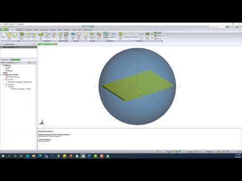

Hi,
It will be good if you can use Feko antenna array script (that is available in Application Macro) to generate the array and then create the cube. Here is the screen shot that I generated the LPDA array with cube using Antenna Array Script.
Here is the link about FEKO (Antenna Component Library and Array tool)
https://www.youtube.com/watch?v=HCNT9J-81-c
I hope this should help to resolve this issue.
Meanwhile, I will review your model and get back to you on the issue.
Thanks!
