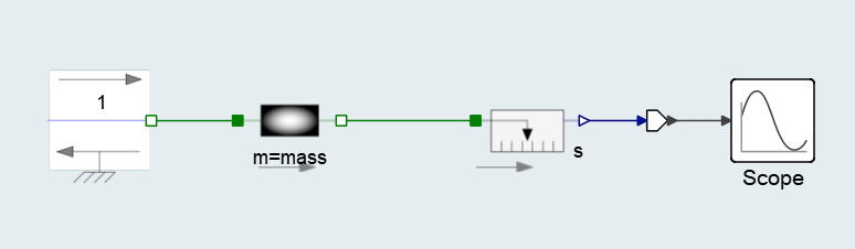

I have one question in simulation.
For example, following simulation, how can I change the mass of the moving part, making the mass as a function depends on the travel.
As below:
0<Travel<50, mass=50
50<Travel<100, mass=30
background for this requirement.
It is due to the design of actuator. We use activate, to simulation the dynamic behavior of actuators. The moving core contains 2 parts, iron part and copper part. The magnetic force is due to the iron part. The total travel is 10mm. But the copper part will stop at 8mm, the iron part will continue to finish the last 2mm.
So, I simplified the topic to the following model. It is like a force is applied to an object. While the mass of the object is dependent of the travel, I need to remove one part of the mass, when the travel reaches specific value.
Thanks.
