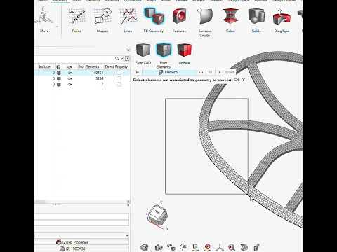

It is pretty weird that I cannot select to create geometry from my elements?
https://www.youtube.com/watch?v=0UCziJReFsM
It is pretty weird that I cannot select to create geometry from my elements? https://www.youtube.com/watch?v=0UCziJReFsM
The video was having problems on my end but FE Geometry is not the same as geometry. See the link below that talks about FE Geometry.
https://2022.help.altair.com/2022.1/hwdesktop/hwx/topics/chapter_heads/fegeometry_r.htm?zoom_highlight=fe+geometry
From FE is still available in the panels in 2022.1.
