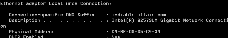

The Ethernet ID is the ID of your machine which is exactly 12 hexadecimal numbers. For example D4WRF478F398
Run ipconfig/all in command window and check for physical address under Ethernet adapter local area connection:
The listed physical address under Ethernet adapter local area connection should be used to generate the license file, if there is no listing of Ethernet adapter local area connection, the address under Wireless Adapter LAN Wifi must be used.
