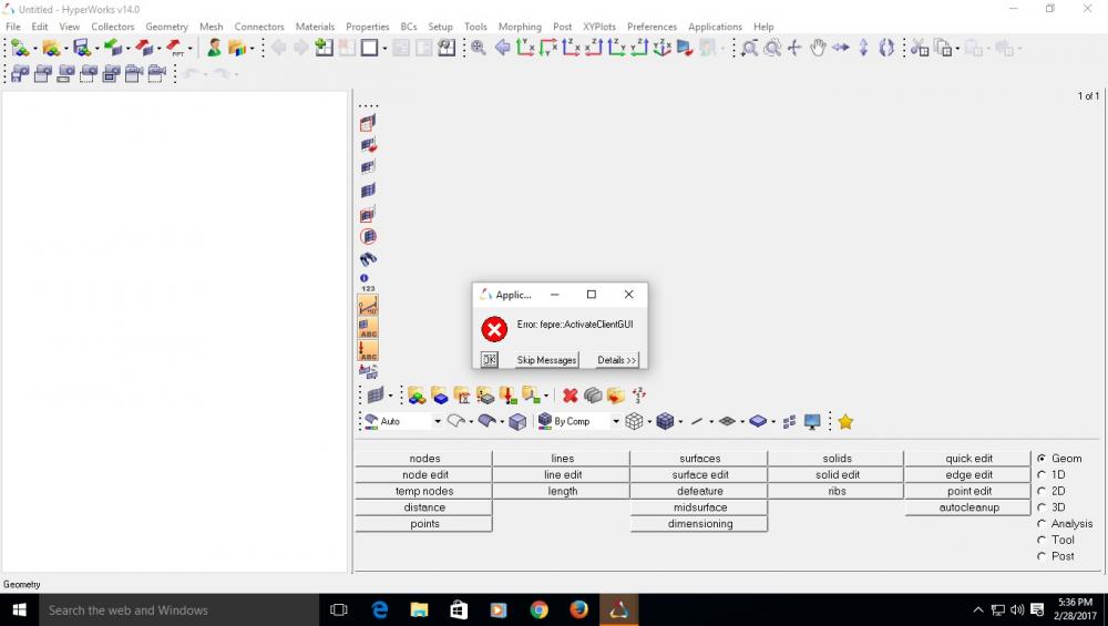

there is error coming when i am using hyper works image is attached below. please help me to solve this.

Dear Student,
In general, Application Error occurs due setup file corruption.
Kindly reinstall the HW SE 14.0 setup with same executable & even if the same problem exist, then download the 'New HW SE 14.0 Executable' from 'Altair Store'
