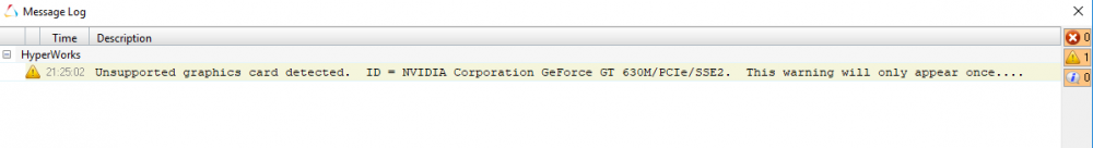

And when I open hyperworks this appears:<?xml version="1.0" encoding="UTF-8"?>
Check Supported Hardware of Hyperworks.
Your graphics card is not supported.
I understand that but there is shoulde be something else. Because hypermesh showes no errors.
Hi Nikita Solovyev
This error message appears because the Nvidia Geforce series are not officially supported by HyperWorks. However, you can still work on it by ignoring the error. You may experience some graphical issues in the future.
See the recommended GPU's for HyperWorks.
