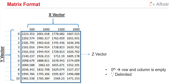

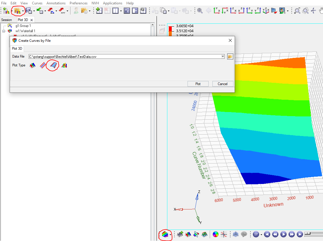

If your data is in matrix format, then you can use Create Curves by File in HyperGraph 3D (see red circles)
Data need to be in the following format:
