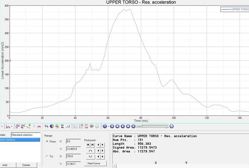

is it possible to calculate the area under the curve in hypergraph and also can u let me know how can i calcutate the integral between 2 points?
Thanks in advance
Hi Prajval,
There are 2 methods by which you can calculate the area under the curve, Abs Area and Signed area.
If you plot any curve and go to Statistics panel and select a curve it populates with all the relevant information. For your reference I have attached 2 documents.
