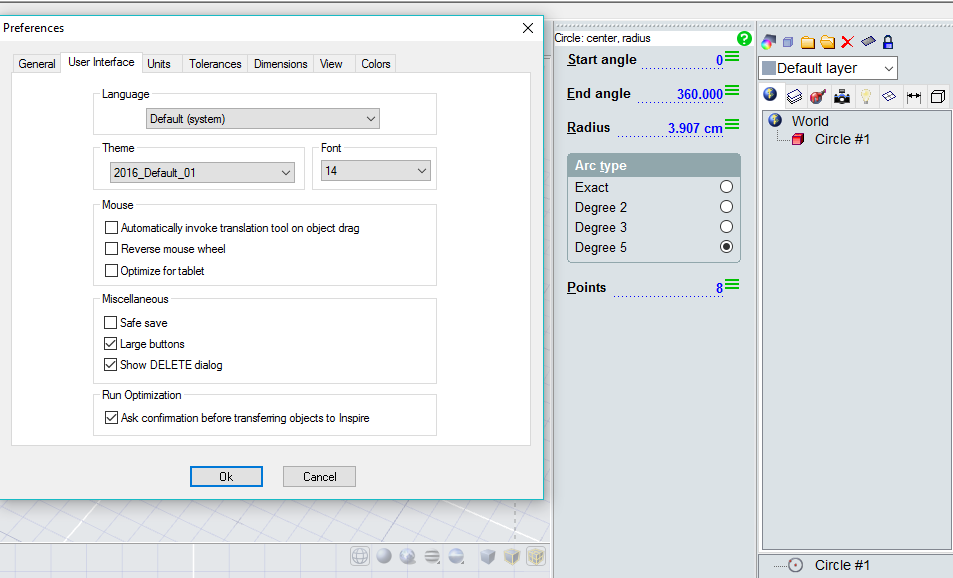

The font size can be adjusted by using the Help-Preferences menu on PC.
Under User Interface tab, you will find the font size option. Please see screenshot below.
Font size does not apply to some pop up tool windows like Curve plot, surface curvature, view detail and so on.
