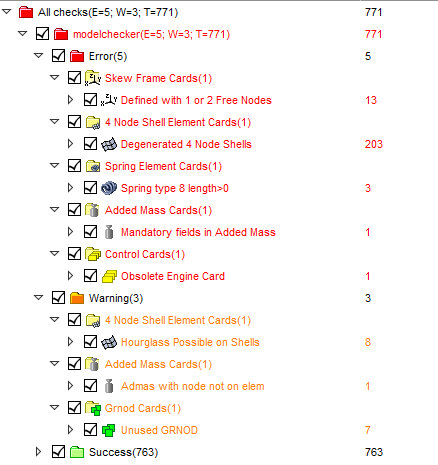

i imported the dummy in HyperCrash with Radioss V2017 user profile ang got some Errors:
i was able to fix all errors except of the Skew Frame Cards error. May the Skew Definition with free nodes be problematic for the calculation? The error only occurs in V2017 user Profile.
Thanks in advance and best regards
any advice?
Hi,
it looks like Skew Frame error is a false positive- it does not prevent the model from running and simulation looks fine. Check the model attached:
