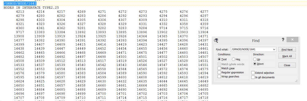

Hello,
how can i check the node IDs in a node group in hypercrash?
Thanks for your help
Zhaoying
Hi Zhaoying,
You can review the node group in HyperCrash but I don't think it's possible to see the node ids of the node group in HyperCrash.
I suggest you to export the model from HyperCrash, manually open the model file (_0000.rad) in Textpad and review the node group where you can see all the node ids.
<?xml version="1.0" encoding="UTF-8"?>
George, thank you so much for your help.
