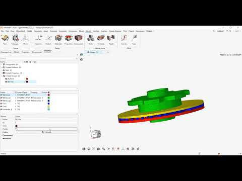

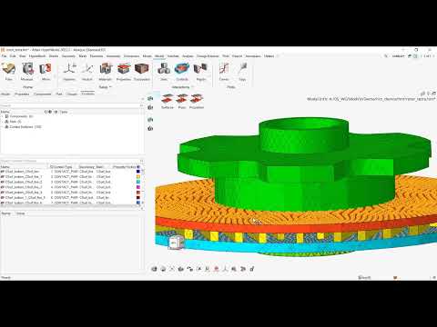

Contact Browser
The contact manager has been deprecated and is replaced by contact browser to ensure a common contact creation workflow for all solvers.A screenshot of a computerDescription automatically generated with medium confidence
How to use Contact Browser:
HM Abaqus Users can refer the following YouTube videos to define contacts using in new interface using contact browser:
https://www.youtube.com/watch?v=SQVPCfmfHAk
https://www.youtube.com/watch?v=pRxPgY4NGXg
