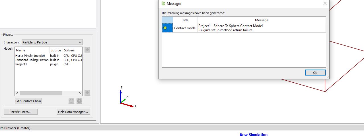

    Hello Stephen,
    i have been trying to compile the Liquid bridge model but i come across this error (see attached). when i disable the SDL checks and open the dll file in EDEM, I get this error message (see attached).
    Thanks again
    Tony

    Hi Tony,
    The EDEM error 'setup method returns failure' indicates the file has been compiled and loaded OK however it is sending an error as it can't find Liquid_Bridge_prefs.txt
    If you place the Liquid_Bridge_prefs.txt in the same location as the .dll that you read then it should load ok.  The .txt file may then need to be modified for any change in inputs.
