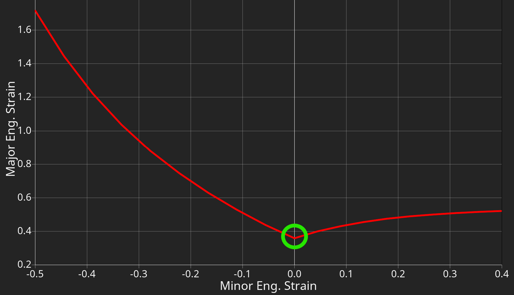

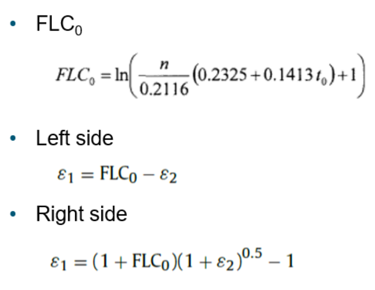

We have the standard formula commonly used in Industry to get the point highlighted below.
Here n : Strain hardening of the material, T thickness in mm. The left side is a 45 degree line in the True strain space.The right side is created using the equation.
are you referring to this?
That is the link I referenced and the description of the mentioned Math option, yes. Are you implying that all that is happening behind the scenes is applying the circled formula? If so, I am confused about how that results in an FLC.
No, it is a part of the overall calculation.
