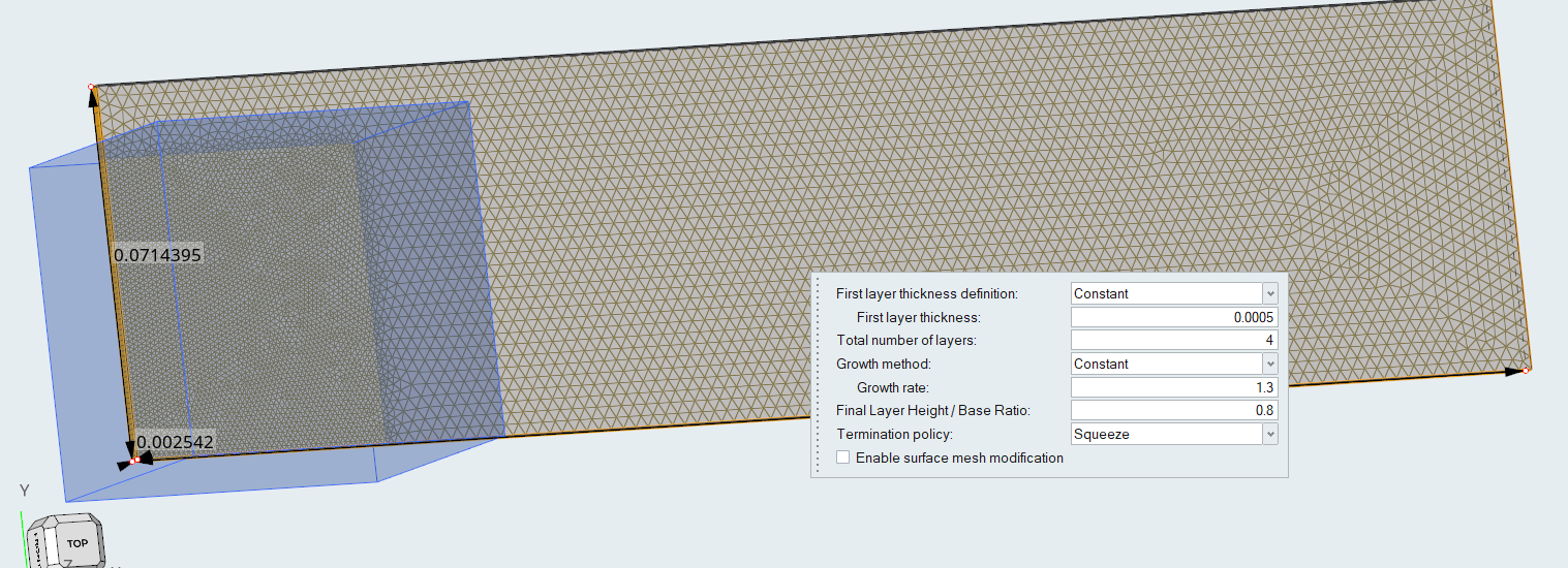

HyperWorks CFD 2022 (available from your AltairOne / Connect login) now does have capability for Extrusion with Boundary Layer. I've attached a screen recording for a simple model.
