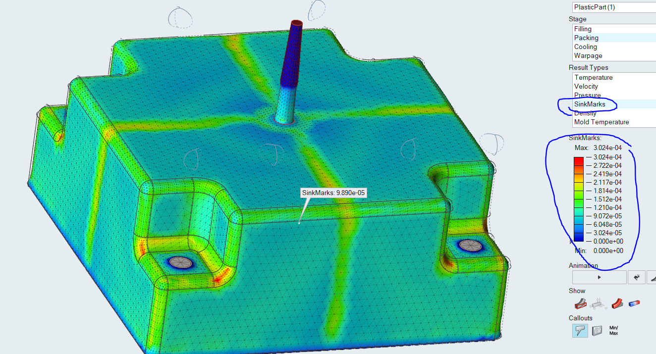

hi expert,
can you tell what is the unit of "Sink Mark" from Inspire Mold?
I looked in the help session but got no information.
Thank you!
Hello,
Sink mark units in Inspire Mold are in Meters. Although due to visual bug in current version, it is not showing on scale. This will probably be fixed in next version of Inspire Mold.
Thank you
Hello @Junta ,
Molding solver writes Sink marks result in SI units of Length ( i.e. meters). When you post-process results in Inspire or SimLab, it will show results in the selected unit system.
Thank you,
Narendra Singh
