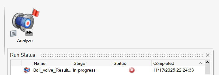

I am completely new with Atlair Inspire. I use this software to explore how to design 3D printed heat exchangers. But before that, I wanted to test basic CFD simulation (only on CPU since my laptop doesn't have discrete GPU).
Unfortunately, I was not able to simulate anything even with files coming from learn.atlair courses (the valve)
or by following the basic tutorial (the manifold). I always get "the simulation did not converge" instantaneously with the red flag (the solver did not start and they are no output data) and there are no log files. And when I open a file with a complete fluid simulation (from the Altair courses) and I want to see the results Atlair Inspire crashes.
So, with that I reinstalled the software, but that didn't change anything.
On the side, I was able to run one FEA case, one topology optimization, create CAD with TPMS, …
Did someone ever face this issue before? If yes, how did you solve it?
Can you help me how to solve this issue?
