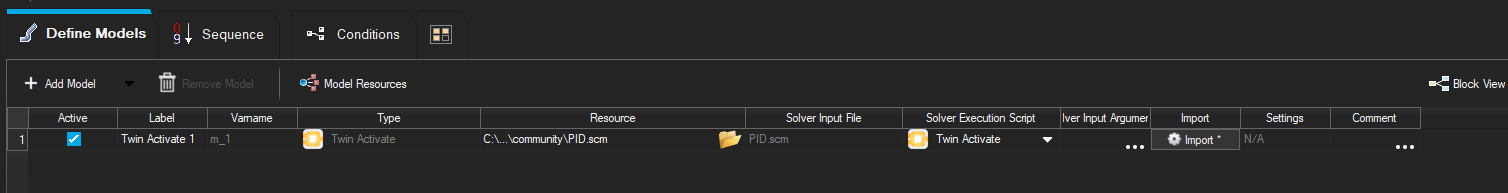

When I create a new study in HyperStudy 2025.1, select Twin Activate as the model type, and point to the provided .scm file, the variable import process fails immediately with the following messages:
Error: Twin Activate failed to generate import hstp file (C:/Users/.../Model1.ta2hst)
Error: Failed to import variables of model (Twin Activate 1 (m_1))

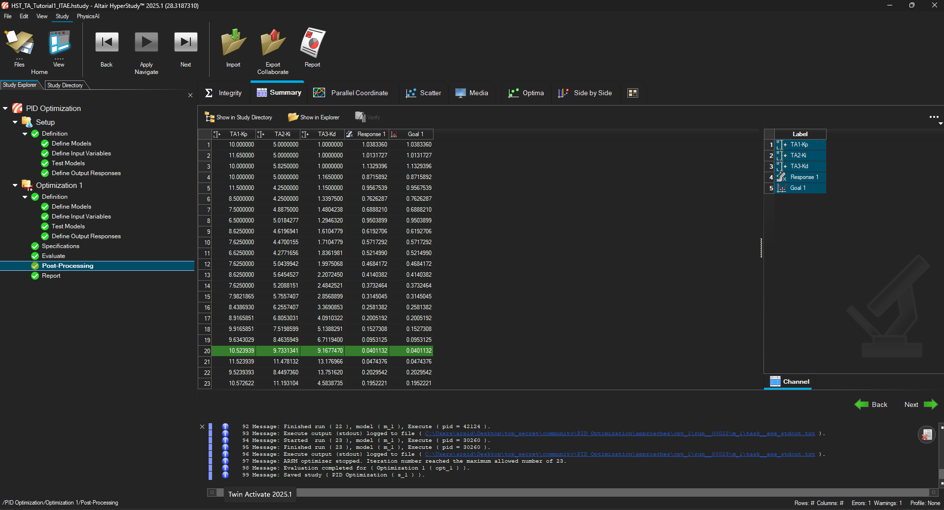

- The tutorial model runs successfully in Twin Activate.

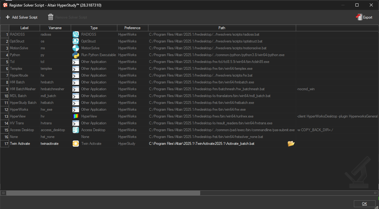

- Both Twin Activate and HyperStudy are version 2025.1, licensed and installed correctly.
I have also tried moving the study to C:\HST\ and testing other Twin Activate tutorial models, but the same issue occurs.
