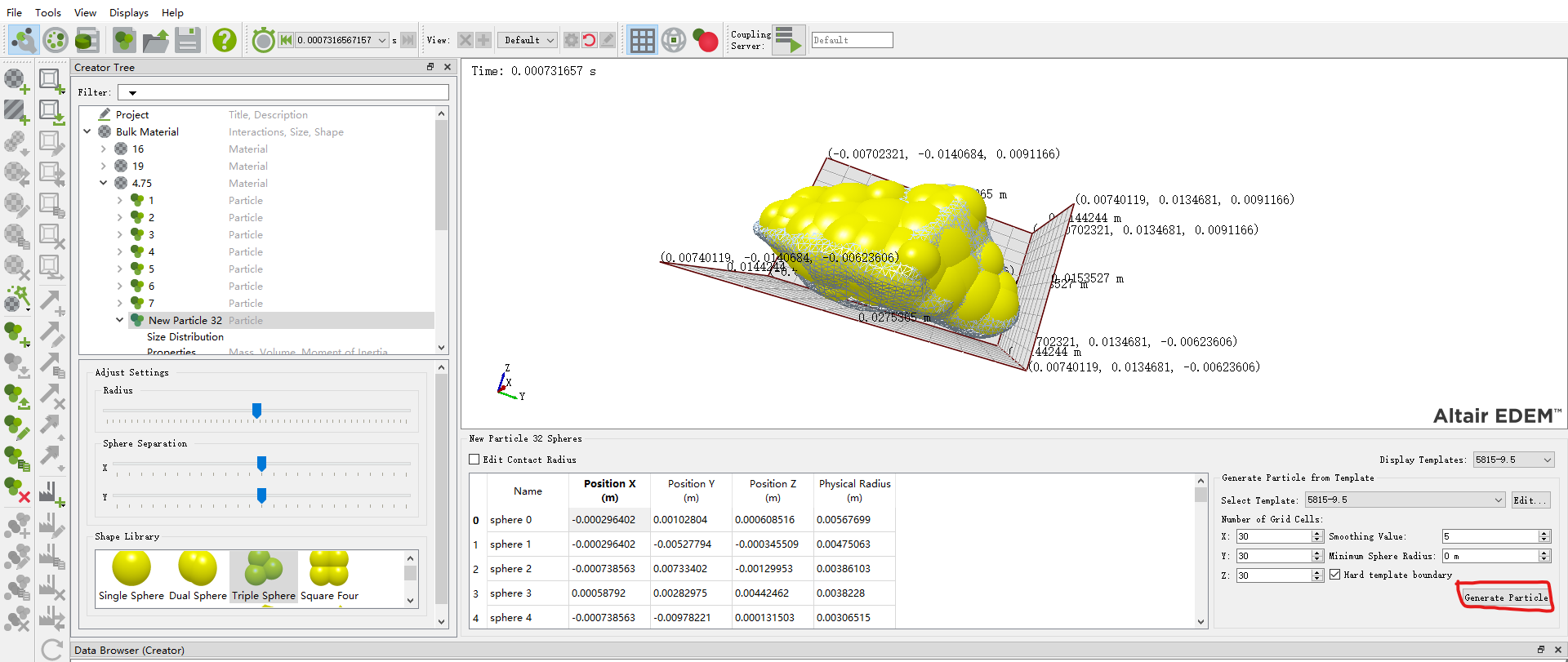

I’ve been learning to use EDEMpy recently and noticed that there doesn’t seem to be a direct method for importing STL files as particle templates. It appears that the only way is to create particle prototypes using the createMultisphereParticleType() function and then add spheres to them via the addSphere() function.
May I ask if there is a corresponding function for the "Generate Particle" method that EDEM utilizes to populate particle models when adding Multisphere particles? Or perhaps, is the source code for this algorithm available to share?
