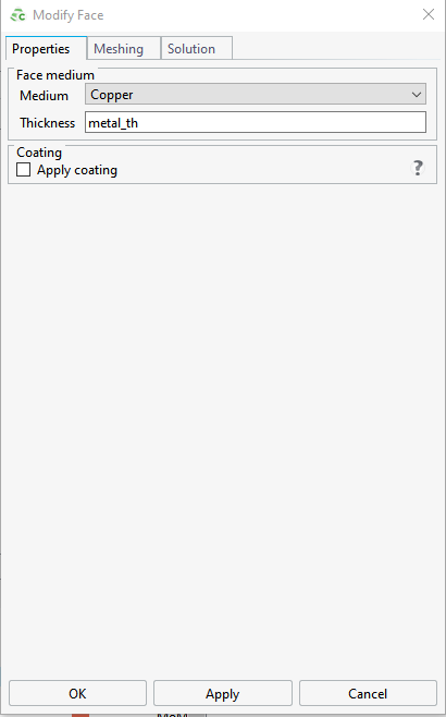

In Feko, I can choose "thickness" when entering a media for one of my layers :
Should i set it to be of the thickness of my antenna ? For example, my antenna here is a flat metallic sheet of 1mm of thickness.
Is 1e-3 the right parameter here ?
Thx !
Hi @degleve ,
The Thickness field in the Face Medium Property represents the thickness of the "material layer" that the face medium simulates. It lets you simulate thin materials without creating a full 3D volume.
If your antenna is flat metallic sheet made of copper, then yes, you can set the thickness of 1e-3 in the face medium.
Regards,
Shannon Mistry
