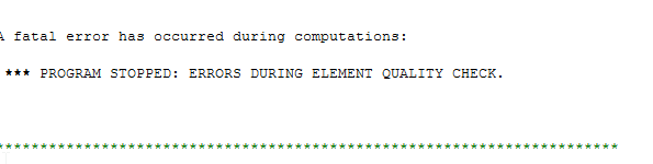

I started a topography optimazation, it broke up, with an Error in the log file
What can I do, to solve this?

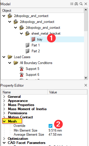

You can adjust the mesh size by selecting the part in the Model Browser and modifying the settings in the Mesh section of the Property Editor.

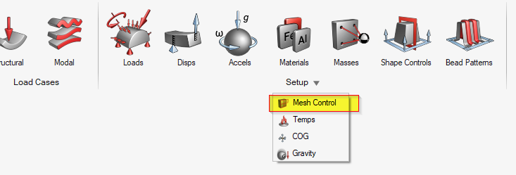

You can also assign different element sizes to different surfaces of the part using the Mesh Control in the Setup section. (Watch this video: https://www.youtube.com/watch?v=QOn-XhfDi_E.)
