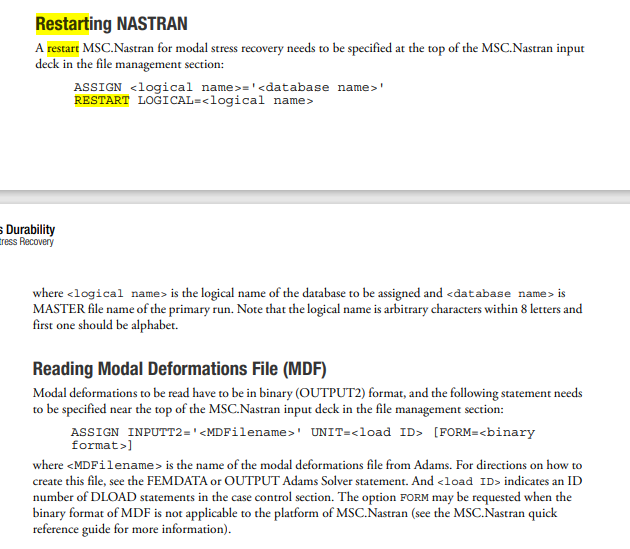

I exported the mnf by running Msc-Nastran and then converted to H3D for MS runs.
The question I have is now I want to perform Modal Stress Recovery from the Nastran run. The problem is I need an mdf file which in the past used to be also a text format but now is binary only. Is there a way to recover this file? Attached some docs about Nastran restart to recover stresses and strains (and in my case MONPNT as well). The MNF file can also include MONTPNT (I do not know if they are considered when converting to H3D but I suspect they are discarded) but it would be a good thing if MotionSolve could handle this feature. The OUTPUT command is not supported by MS.
