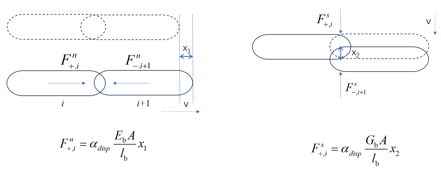

The Fibers Bonding Model applies a bonding force and a bonding torque to both particles according to a set of stiffnesses, which can be decomposed into: one axial stiffness, two shear stiffnesses, one torsional stiffness, and two bending stiffnesses. For two sphero-cylinder particles of the same material, a Fibers Bonding Model is used to establish a connection. I would like to analyze the direction and magnitude of the forces between the two particles under this model. The following analysis is based on the help documentation and my experience. I would like to consult everyone on whether there are any issues with this.
