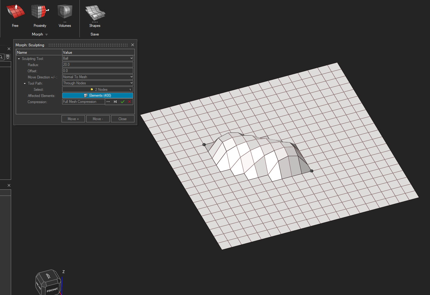

Can you please verify what you mean by "foam"
works something like this
After placing the dummy in the seat simulation, it is necessary to preload the foam on the seat to make it fit the dummy and avoid interference. I am trying to see if this feature can meet the requirements, but I am a bit unsure about how to operate it.
