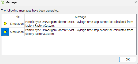

I tried assigning the name of the meta particle to the type parameter in the createParticle function in order to create it at the desired position.
and i get error like below.
Is it impossible to create a meta particle at a specified position using the API Factory just allocate the center position of meta-particle like that way?
I suppose it might be possible to implement meta particle generation  using the positions of the particles ( Bulk material ) that make up the meta particle. Still, I would like to know if there is a direct way to create a meta particle itself.
