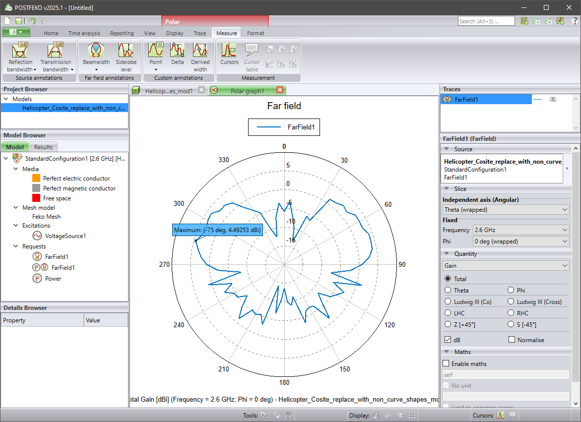

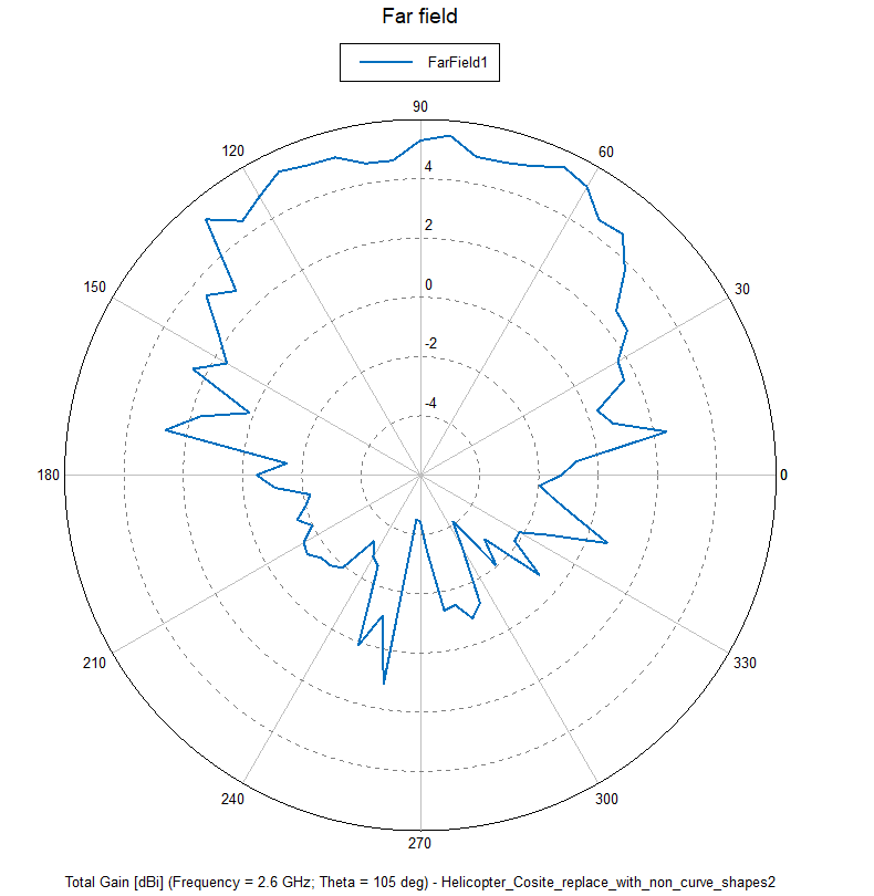

A monopole antenna on the helicopter should have about 5-6 dBi of farfield gain. When using PO-LE (coupled with MoM) and limiting it to 1 iteration, it shows about 5-6 dBi of gain.

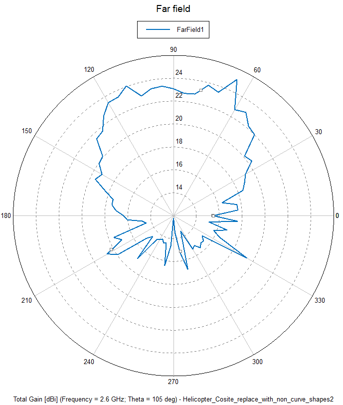

However, as the iterations increase, so does the gain, until ulimited iterations gives >23 dBi of gain!
What am I doing wrong? Does PO-LE only work for coupling and not for farfield results?

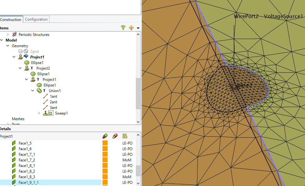

For testing purposes, I created a helicopter representative model…
