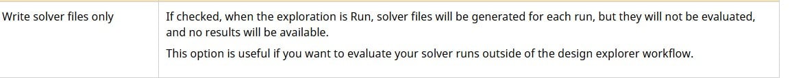

I want to run the exploration on remote desktop that situated at the other location. In this case whether I need to use the solver scripts??

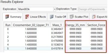

Currently I am trying option of "writing solver files only " and running the simulation on remote desktop. But after simulation completed design explorer not extracting the results. Showing error of report not found.
so, to solve this issue report generated using the Hyper study, now results extracted but showing some different values. (9999.99)
