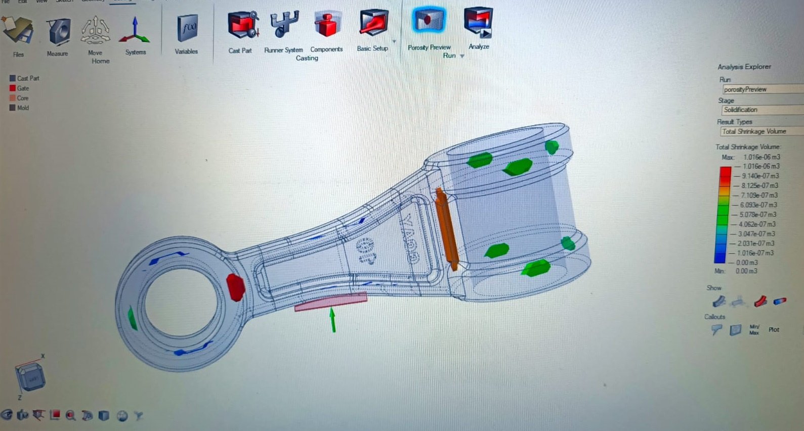

I simulated the casting as a single figure. I checked its porosity. My question is, based on which values should I choose a feeder?
Dear Eozmen16, Greetings, For creating the feeders (risers), you can check the results for geometric modulus in the result type option and maximum value can be used when creating Risers in Inspire cast using components tool.
Please check and let us know if this helps. Thanks.
