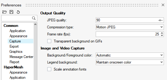

When creating a GIF using the screen capture tool in Hyperview the resulting gif is just so fast to be usable for nothing, how can I control this speed? I don't see any parameters to control this…
Hi @Danibel
The easiest solution I'm aware of is: File → Preferences → Capture → Reduce the frame rate (fps)
Thank you! this works perfectly.
