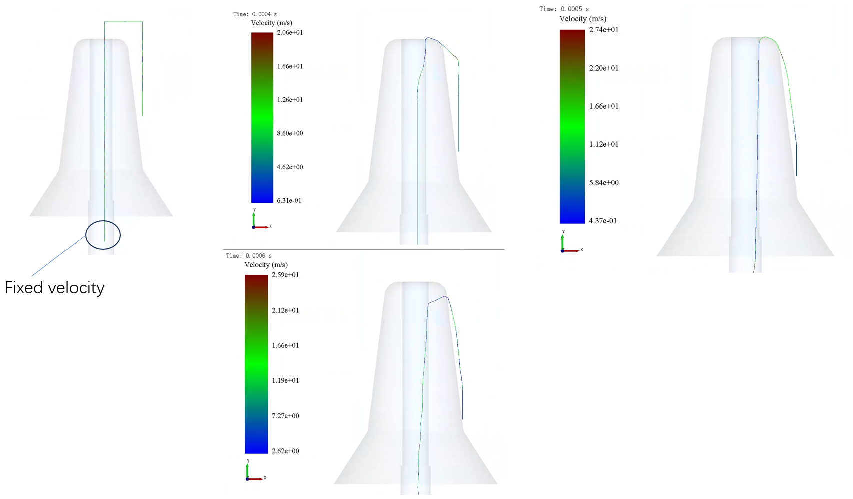

Hi Everyone,
I am studying the falling process of a long flexible body and need to ensure that the tail end of the long flexible body maintains a descent speed of 5 m/s. The long flexible body uses the fibers bonding model in EDEM 2025. The particles at the tail end of the long flexible body are set to a fixed velocity, while the other particles are not set to a fixed velocity. When the long flexible body collides with a geometric object, it begins to deform. However, after a period of time, the long flexible body penetrates the geometric object. The cause of the issue is not entirely clear. Do you have any good suggestions?
Best regards,
Bai
