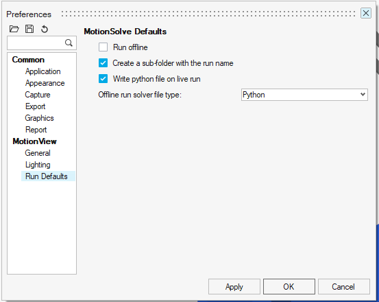

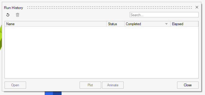

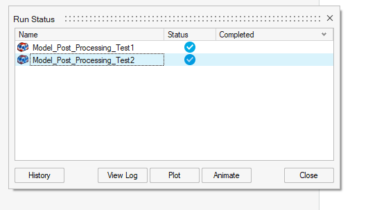

As the Title says my Runs won't get saved in the Run History. I can only see them again in the Run Status window if I start another Simulation. I tried changing the Output Directory in the Run Motion Analysis window, but that didn't work. I couldn't find a Preference Setting to help me with my Problem (deselecting the "Create a sub-folder with the run name" changed nothing), running the Simulation Offline also didn't save the Run in the Run History. A new _snapshot.mdl file is created when running, maybe that has something to do with it? I would really appreciate your help or insight.
