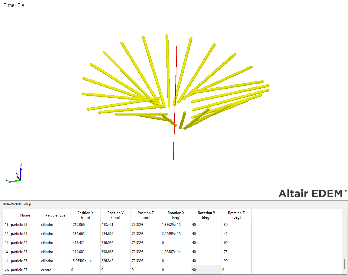

Hello, i can't rotate particles arround a sphere, their rotation axis x and y are overlapping.

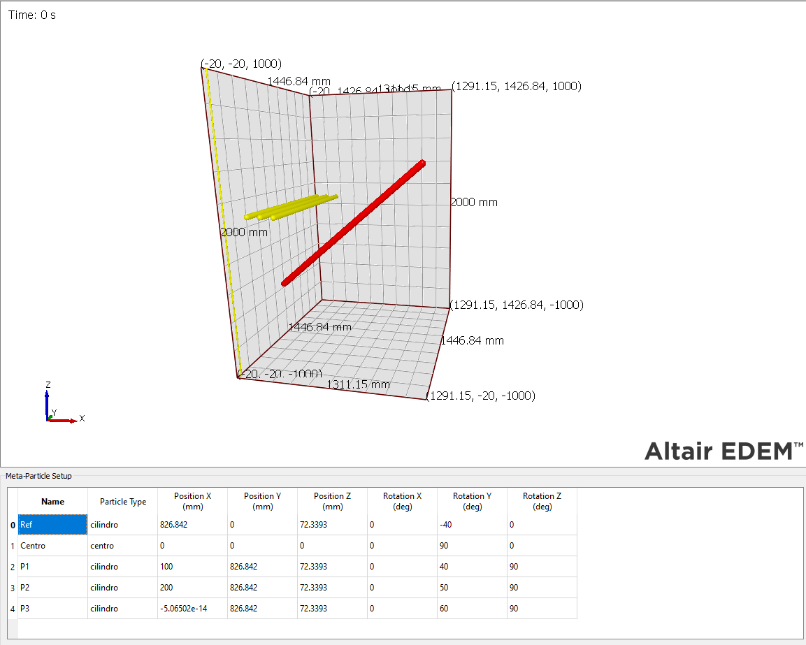

Hello, I will try to explain better with this image
I created 3 cylinders (P1,P2,P3) and I can't rotate them to the vertical position, if i try to input any value in Rotation X, it's passed to Rotation Y automatically and doesn't matter what i put in Rotation Y, it doesn't affect vertically.
But if it's with 0 in rotation Z, i can rotate vertically, it's what is happening in cylinder Ref.
I did like to know how i can put P1,P2,P3 equal cylinder Ref, but with rotation Z in 90 degrees.
In my first image, you can see how rotation Z is affecting gradually the vertical inclination of cylinders.
This is a known issue within EDEM, so please try alternate ways of reaching the orientation you require without making Z to 90 degrees. For example, (40,0,90) can also be achieved by (0,90,40).
