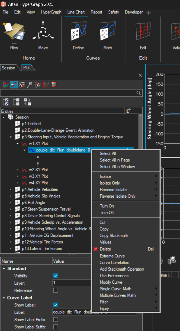

To modify curves in HyperGraph, simply right click on the curve in the Plot Browser and select Modify Curve, Filter, Single Curve Math, or Add Stackmath Operation.
You can also use the Define Tool to create a new curve and define it with expressions to add things like a Butterworth Filter (shown):
Hope this helps!
