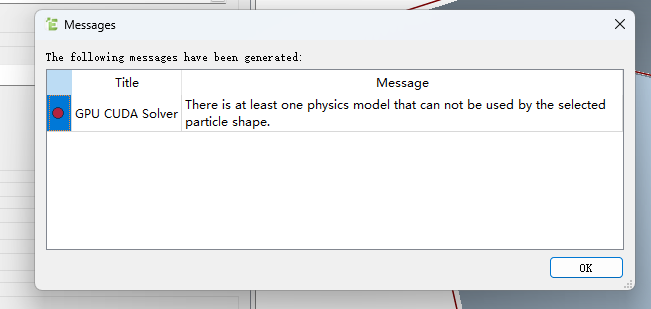

Hello, I used polyhedral particles and spherical particles in the simulation. The following hints are encountered in the simulation : ' ERROR : GPU CUDA Solver : There is at least one physics model that can not be used by the selected particle shape. Attachment is my simulation file, please ask what this is, thank you for your time to view this issue, thank you !
Hi Taijin,
Fiber bonding model won't be supported polyhedral, it supports Sphero cylinder.
