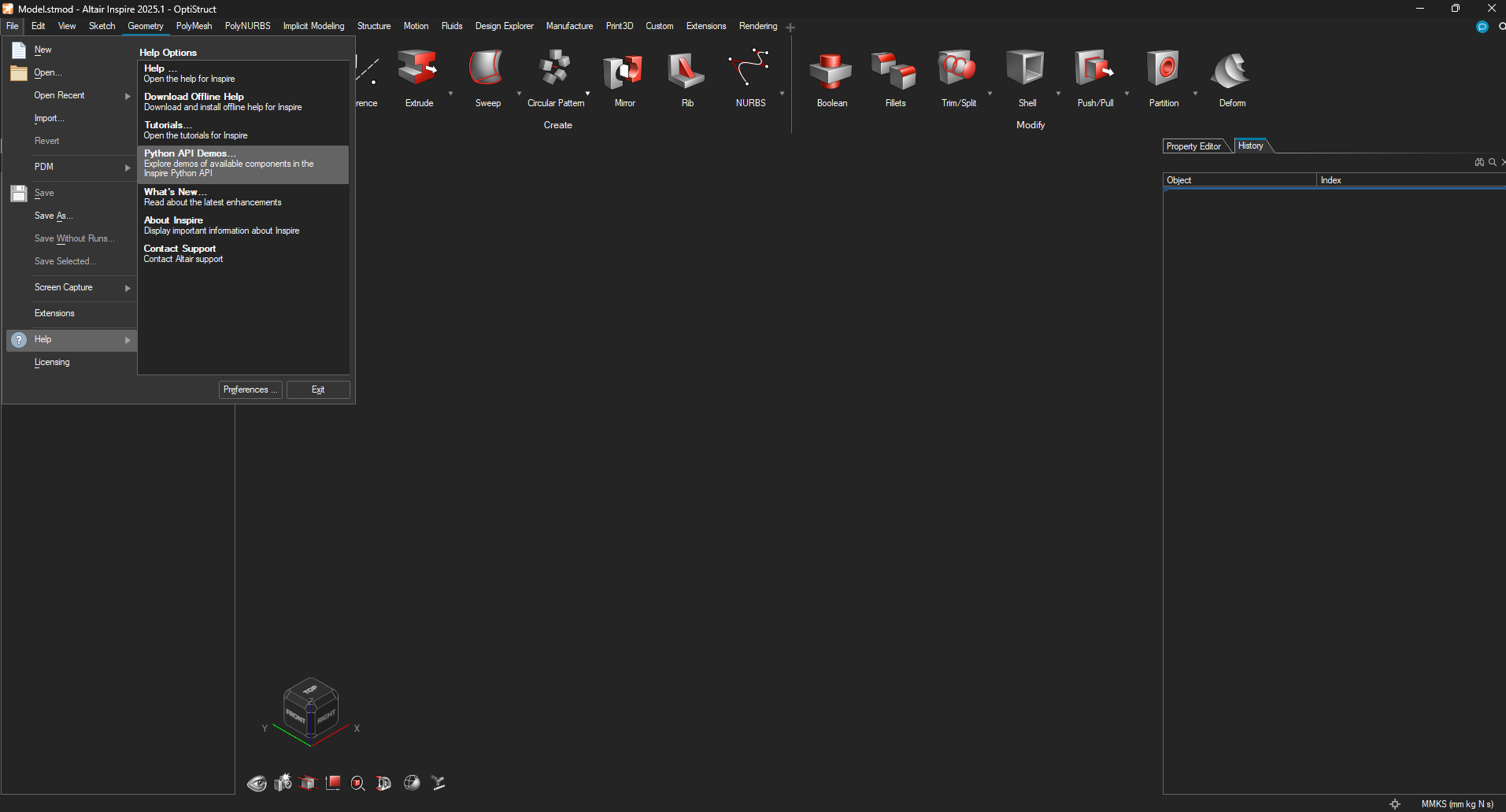

I am testing Inspire Cast 2025.1. I would like to explore the Python functionality, but it seems there is no proper IDE, just Jupyter Notebooks, is that correct?
Hi @dhalpin,
Inspire does feature Python API.
Please find a link to the help documentation below:
https://2025.help.altair.com/2025.1/inspire/en_us/topics/inspire/reference/python_api_c.htm
You can also access demos from File » Help » Python API
Hope this helps!
Adam Reid
Thanks @GTT Adam I realized I had to load the "Developer Tools" in File/Extensions to see the actual Python IDE.
