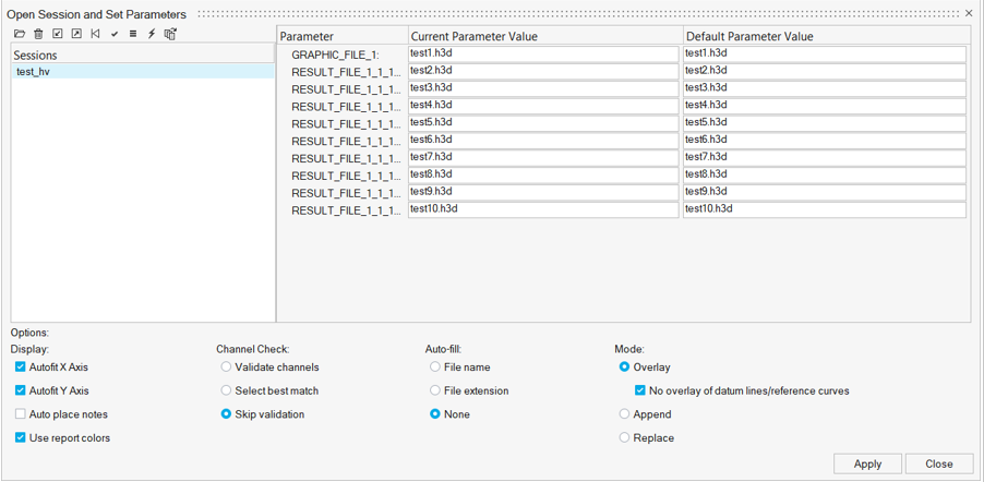

how can I apply style in Hyperview from one model and already created pages with views on another model. I have tried several methods with "apply style", but I still have not come to any positive results.

Hi @Vitaliy_Finonchenko,
This process is commonly accomplished using Flexible Reports.
Typically, once you have a session set up for your first model you can go to File » Save As » Report Template.
You can then go to File » Session » Flexible Report, to load a report and then replace the original filenames with those of the new filenames you want to apply the report to.
Hope this helps!

Dear Adam, greet you! Thank you very much for your quick response! Your solution is absolutely that, what I need!
