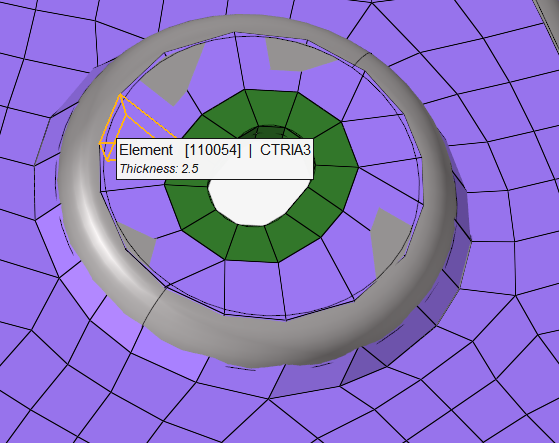

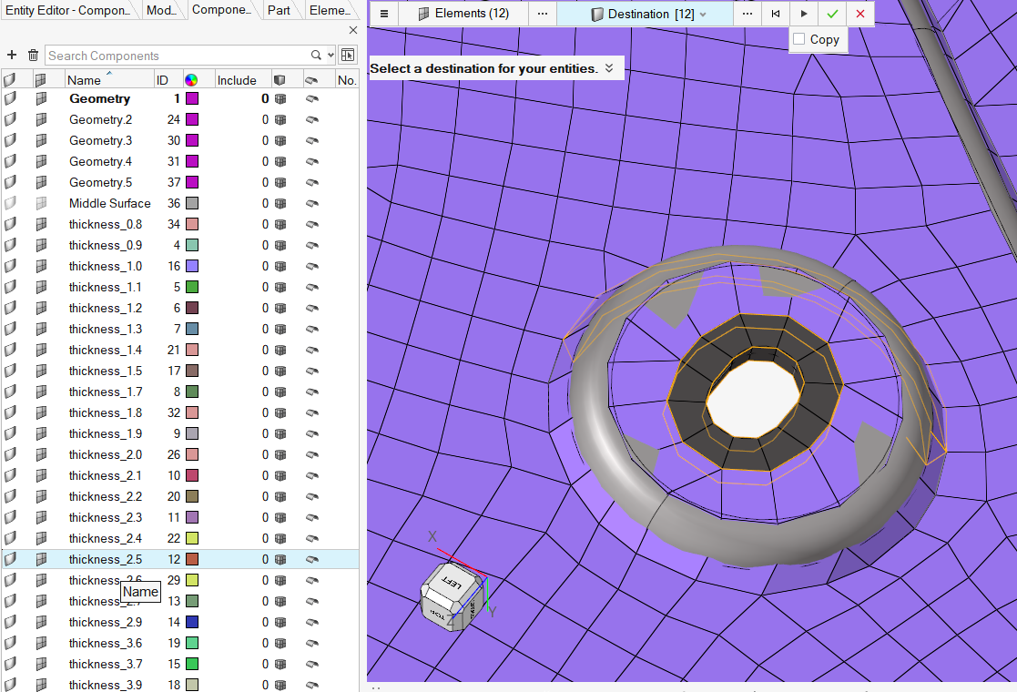

The thickness of the washer elements here were automatically assigned as 2.495. However for all other elements i have thickness values upto one decimal only. So here also i want it as 2.5. But if I use organize tool to change the collector to 2.5 thickness category, they are still staying the same and not getting changed.

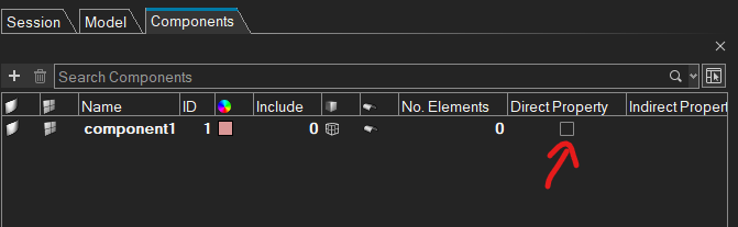

make sure these elements have no 'direct assignment' for property.
If that's the case, even if they're at the right component (indirect assignment) it might have a different thickness due to direct assignment.
if that's the case you could get rid of direct assignment by unchecking this box. This way only indirect property (component) will be considered.
