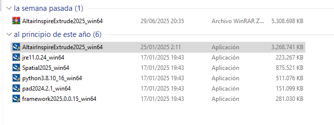

Hi, I followed the following video and PC is new. I also introduce the license successfully

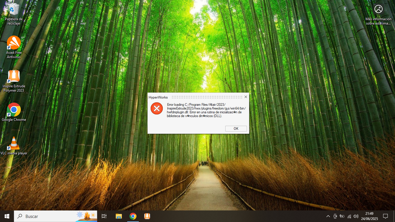

While I try to iniciate the software inspire extruder polymer, it appears two errors and I don´t now what is wrong.
Is there any solution?
HI @tole5

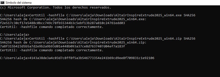

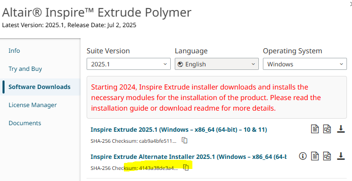

This is an issue with your installation / executable file, please ensure your downloaded file is not corrupted during download as per -
they are not the same.
What shall I do? Because I reinstalled it two times and the same problem still happens. Could the windows defender be? the PC is new.
@Rahul_P1 which is Next next step to achive achirvthe installation of the software?
Hi @tole5
You need to download the software again, make sure the download is not interrupted, the checksum should match, if not the installation step will not work …

I also check the download installer and now is the same and it is correct.

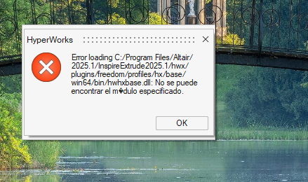

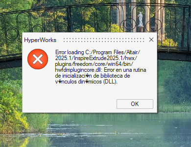

I see that you have installed the software multiple times, and it has not resolved the DLL issue. I would suggest a few things as follows - 1. As you have a new system/pc, there should not be an issue with the drivers. But for the safer side, check if you have any driver and GPU updates. If yes, then get those drivers and the GPU updated. 2. As you have already installed the software, please check if you have those DLLs (mentioned in the errors) present in the respective folders. Also, check if your antivirus or Windows Defender is blocking or deleting those DLLs. If yes, you can unblock those DLLs. Check if you can launch the application. If not, I would suggest uninstalling the software completely and then reinstalling the software by switching off your antivirus. So that the antivirus will not block or delete any DLLs. Let us know if it works. If the issue persists, please share your complete system configuration. For this, you can type DxDiag in the Start menu and save all information.

The DLL archives are located in their carpets
I have just reinstalled the software without antivirus and the same DLL problems. The installer checksum tutorial is correct.
