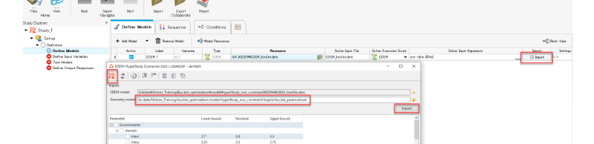

Hi, I am using Inspire 2025, Hyperstudy 2025 and EDEM 2025.
I have been trying to follow this:
When I am trying to import the geometry in Hyperstudy like they did:

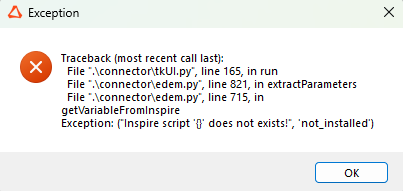

An error message comes up that reads:
Is there a solution for this problem?

Hi Garima, I have installed the 2025 connector! BR
I have been able to use Hyperstudy and EDEM together before, but then I only used to do an AoR study and didn't change the Geometry.
Thank you for the response.
@Stephen Cole can you help with the Inspire error mentioned by the customer?
Parametric definition was broken in Inspire 2025.
I recreated the Inspire Model using Inspire 2025. Could you please try it?
The same warning came up sadly.

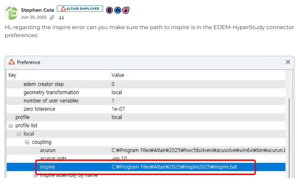

I have checked the model works well on version 2025. I attached the confirmed model on the original thread.
Thank you, this solved the issue with importing the geometry:
My preference was prefilled with not_installed for some weird reason.
