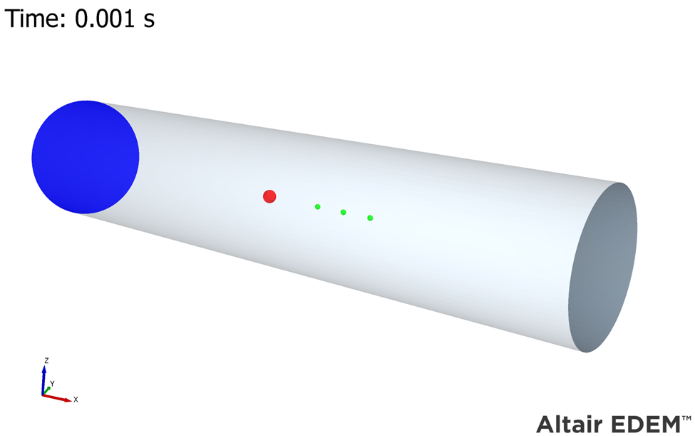

Sample Case
This sample case demonstrates the SprayConduction API applied to a simple setup involving:
- One solid particle with an initial temperature of 360 K.
 - Three spray particles are aligned along the same path, each with an initial temperature of 273 K.
As each spray particle impacts the solid particle:
- The solid particle’s temperature is updated instantly to the computed equilibrium temperature based on the mass and heat capacity of the solid and spray particles at that moment.
 - The spray particle is removed after contributing to the heat exchange.
This case illustrates the model’s ability to perform sequential temperature updates as multiple sprays impact the particle.
