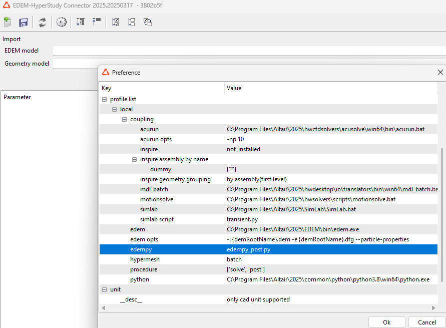

I have the 2025 version for both EDEM and Hyperstudy. I used the calibration kit which I got when I downloaded EDEM. Everything has worked until I have to choose my output CSV file. No warnings came up when I ran my definition but it seems that the python code does not create a CSV file. Does anyone have any tips?

3. In the HyperStudy connector settings the default script name is 'edempy_post.py'. Can you make sure that either your script is named the same or that you edit this to be same as your script name
