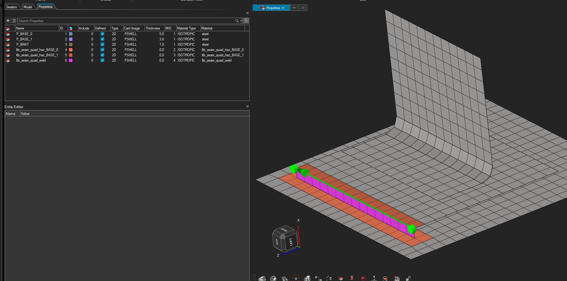

Hello, I am studying hypermesh, and I want to connect 3 shells by seam weld with HAZ. When I tried to realized the connector, the thichness of seam weld and HAZ are zero. I can' t find the reason. Could anybody try to check my model? I attached my model and the detailed questions. Many thanks.
your properties aren't assigned to your elements on the base parts
PLease refer to the following resources as well
https://help.altair.com/hwdesktop/hwx/topics/pre_processing/connectors/realizations/seam_quad_ltb_c.htm?zoom_highlight=seam
