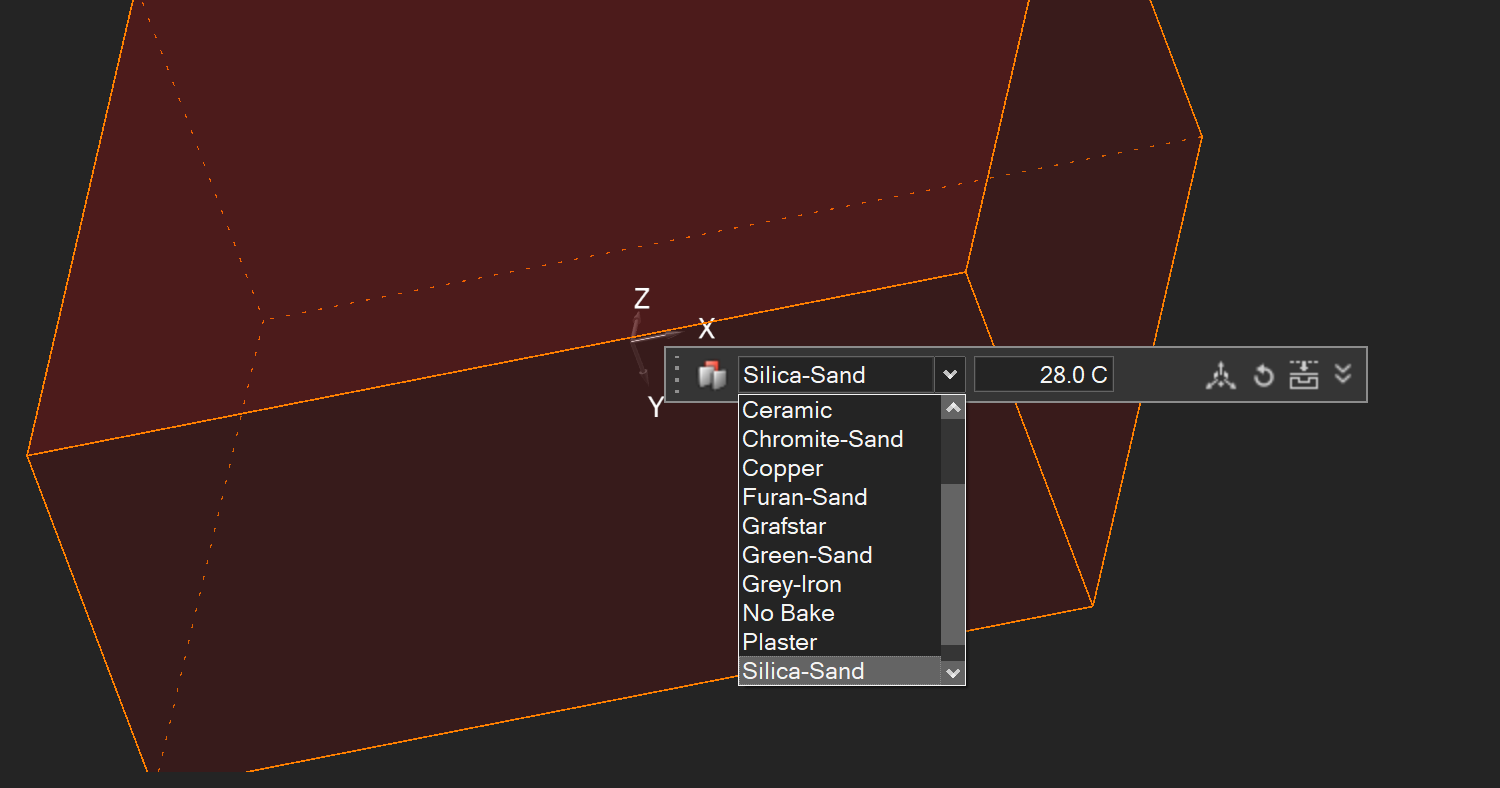

WHAT MATERIAL DO I SELECT IN THE MOULD MATERIALS SELECTION BAR to GET THE CO2 sand TYPE MOULD, I THOUGHT OF SILICA SAND, SO I HAD TO SELECT SILICA SAND. SO WHAT WILL BE THE CORRECT CHOICE OF SELECTION?
Hi @venomousDNA ,
Inspire Cast does not have specific sodium silicate mold. However, the silica sand is the closest one that you can select as silica sand is a key component of both. If you need specific properties then modify the Silica sand material to your sodium silicate properties.
