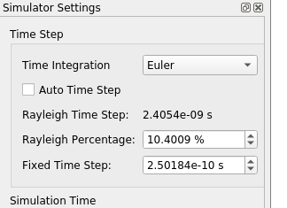

Is it because of the time step i am running it in 0.1% raleigh time step

I also notice that the time step is set to 10% when i download the file to postprocess it it i dont know why this happens i thought keeping tmStp=2.5e-11 will keep the time step fixed.
Can anyone please suggest what to do and how to proceed so that the time step remains as I specified and the bonds do not break0 -

and also the time step jumps like this
So can anyone please suggest how to keep the time step fixed at say 1% and what is the syntax for incorporating the gpu split and anything else if it is a mistake
