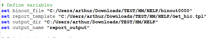

I would recommend to removing the OneDrive reference in the filepath and also switch from "\" to "/".

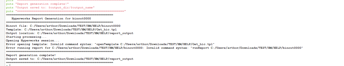

I´ve just created a dummy example to check if the scripts is working making these changes.
