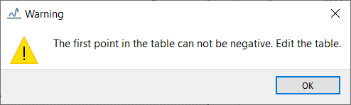

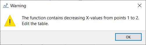

Let me remind you that the essence of the question was how the stress-strain curve is determined at stresses and strains < 0.
Most likely, we can conclude that this is not possible in the SimSolid 2025 version. According to the announced information of the new version 2025.1, it is also clear that this problem has not been solved.
Thank you for participating in an attempt to solve this problem!
